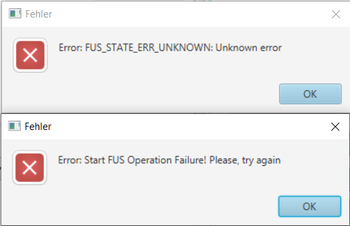

When I try to start FUS, I get this:

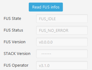

When I try to read the FUS version, I just get this:

.\STM32_Programmer_CLI.exe -c port=SWD -fusopgetversion
FUS Operator Version : v3.1.0
fusopgetversion command execution finished
.\STM32_Programmer_CLI.exe -c port=SWD -fusgetstate
FUS_STATE_IDLE
getFUSstate command execution finished
.\STM32_Programmer_CLI.exe -c port=SWD -startfus
Reconnecting...
Reconnected !
Error: FUS_STATE_ERR_UNKNOWN: Unknown error
Error: Fus is not yet running, try again
.\STM32_Programmer_CLI.exe -c port=SWD -startwirelessstack
Error: startwirelessStack Operation Failure! Please, try again.\STM32_Programmer_CLI.exe -c port=SWD -fwdelete

I really don't know what to do at this point. I've already looked at other similar issues here, tried different connection and reset modes, I tried the boot0 bootloader method, I did a "factory reset" with this command:
STM32_Programmer_CLI.exe -c port=SWD reset=HWrst -w32 0x5800040c 0x00008000
And nothing changed. At this point I'm clueless, have I locked my self out of the CPU2?

Looking at the secure option bytes, SFSA is pointing to a previous version of the FUS.
Please use the startfus command and then read the FUS version using the fusgetversion command.
Let me know which version it is. If it is not higher than v1.2.x, then you have to upgrade the FUS with the latest version that you should find under \Projects\STM32WB_Copro_Wireless_Binaries\STM32WB5x.
In that case, depending on the current FUS version, I will tell you which FUS binary to use.
Once FUS is updated, the wireless stack will be correctly uploaded.

I had a lot of back and forth with ST support over multiple tickets, but ultimately, they couldn't find a solution. Quote from the ticket: "yes, unfortunately your board CPU2 communication with CPU1 is locked without recovery option - not possible to run BLE application on this board." After that, they sent me a new board.

A few recommandations:
To know the FUS version, first do a StartFUS command and then issue a GetFUSversion command.
Looking at the secure option bytes SFSA and SBRV, you can guess whether the FUS or the Wireless stack is active.
If SBRV = 0x46000/4 = 0x18800, then FUS is active. 0xA000 is the space size reserved for the FUS in WB1x devices.
