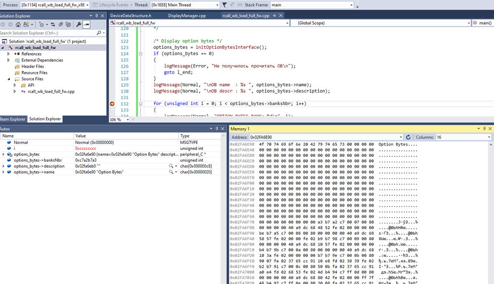

And after call I see that the banksNbr = very big value.
Its a same for 32 or 64 platforms.
This is 32 platform:
0693W00000AM1ozQAD.pngAs you see, options_bytes address = 0x02fa6e90.
If we add to this address lenghts of fields name[32] and description[200]
our result will be 0x02fa6f78 as we can see that
banksNbr = 0xc7a2b7a3.

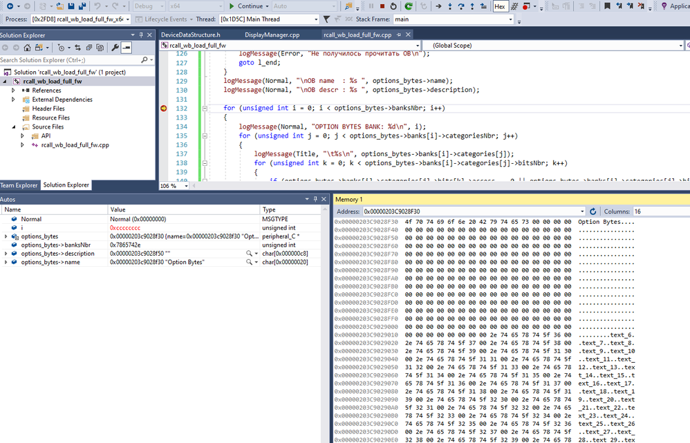

This is 64 platform:
0693W00000AM1qgQAD.pngand we can see the same, but more interesting is a fild " bank_C** banks;"
banksNbr = 0x7865742e.
What is a "text_6", "text_7" ... ?
So, x64 dont work ?
Why in different platforms we have a different data returned by function initOptionBytesInterface() and not correct data?

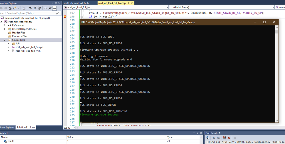

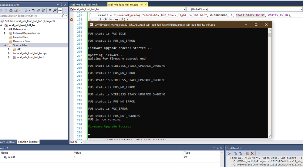

Next trouble:
When call firmwareUpgrade() with stack and parametere "startStack" = 1 then
function return "1" (error) but stack loaded succesfully and fus dont run :
0693W00000AMuUuQAL.pngWhen call this function (firmwareUpgrade()) with stack and parameter "startStack" = 0 then
function return "1" (error) again but stack loaded succesfully and fus still run:
0693W00000AMuVJQA1.pngWhy firmwareUpgrade () always return 1 (false)?
