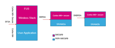

Hello @Smalik
For the 1MB of flash on the STM32WB55RG, this memory is divided into two parts limited by the SFSA value. A protected part dedicated for the cortex-M0+ (Stack, FUS,...) and a second part dedicated to the User application on the Cortex-M4:

Hello @Smalik
In fact, The SFSA is automatically adjusted to the start value of the installed stack. the part from the address 0x080000000 to the SFSA address can be used by the user application.
