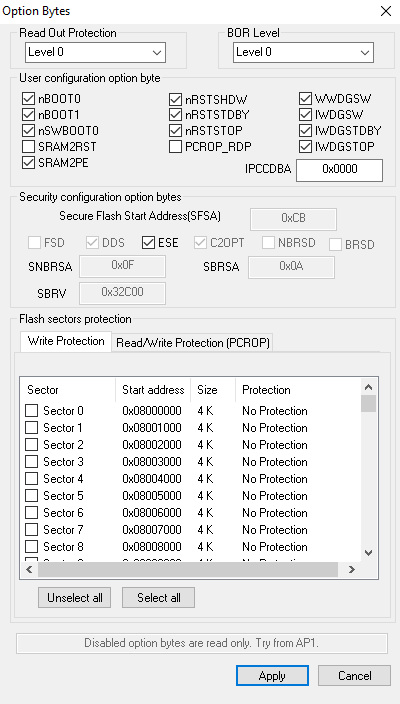

Then could you download all the option bytes?

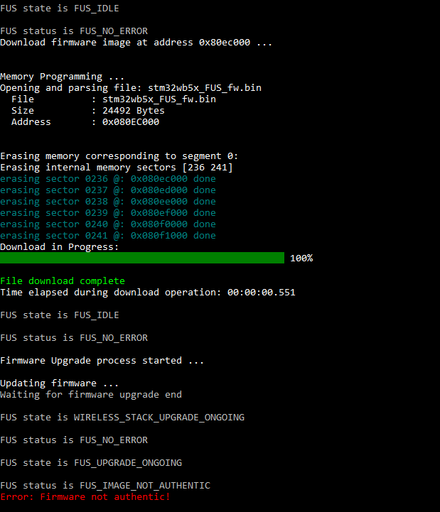

Here are the option bytes and the log where I followed the steps in the release notes. Except that here I try to upgrade FUS even though I have the expected value to go to STEP 6. I do this because when i tried to pudate FUS before I didn't had expected value from ( i was having : 0x20030030 : 00050300) and I ALWAYS came across that FUS_IMAGE_NOT_AUTHENTIC error.
As you can see i try first to read the current FUS version before doing fwdelete and I get -> 0x20030030 : 00000000.
Is this normal behavior ?
2019-10-24 5:24 AM
In fact, all is OK. Just after performing the fwdelete correctly, the reading of the FUS version is 0x01000200 which is the correct version V1.2 for the FUS.
Then you try to upgrade the FUS from the CubeWB FW package which is V1.2 too. So this it is not needed. I understand the error message is a bit misleading but this error happens when you try to update the FUS with a new one with the same version.
Then the RF stack update completed correctly. So no issue. If you read the FUS version now It should still be 0x01000200.
You can now download the user application at 0x08000000 et it should work fine.
