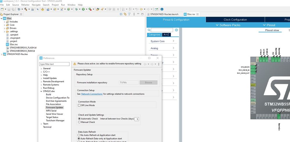

Could you share where is your firmware packs repository (Preference windows below snapshot like).
Could you have a try promoting another workspace repository. Sounds you're relying on default what's good but to help figuring out what's not ok if your local env may help to have an extra try.

  • Go to Help Windows > Preferences > STM32Cube > Firmware Updater
  • Browse new 'Firmware installation repository' (for example Downloads folder)
  • Click 'Apply and Close'
