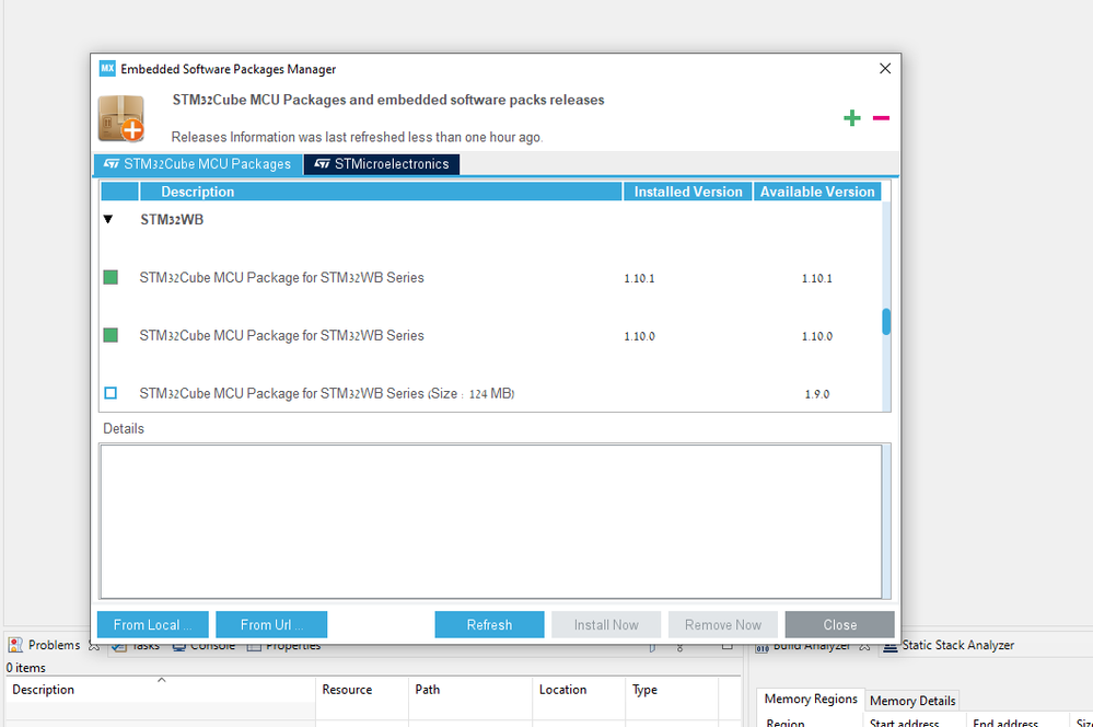

Backing to one of your screenshots:
0693W000008GC5HQAW.pngI can see here that STM32Cube_FW_WB_V1.10.1 firmware is correctly installed. Thus, normally the misbehavior is corrected.

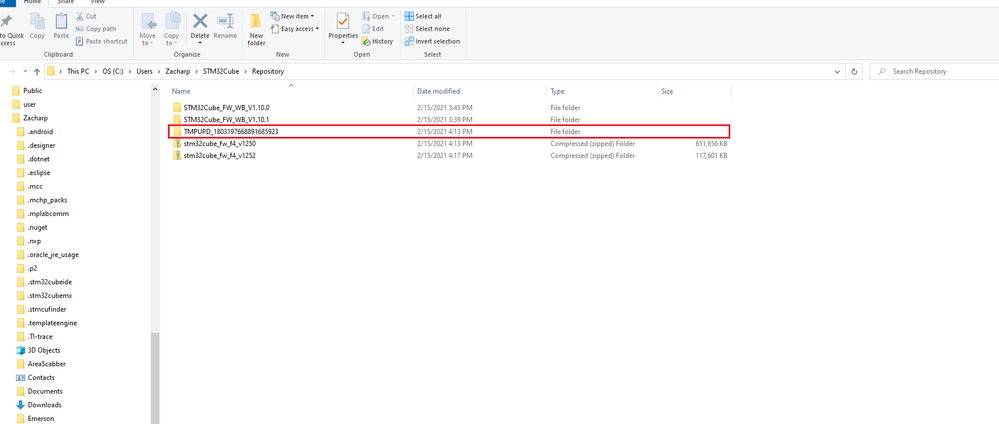

Otherwise, backing to the following screenshot:
0693W000008GCH3QAO.pngNormally the framed folder will disappear automatically after the end of the download process. Does this happens in your case or do you always see this file in your repository folder?
PS: Trying to delete the "TMPUPD_.... " folder above during firmware install corrupt the unzip process and in this case the "Target directory already exists" error may occur. In addition, trying to modify the content of this folder fails the install process.
