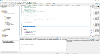

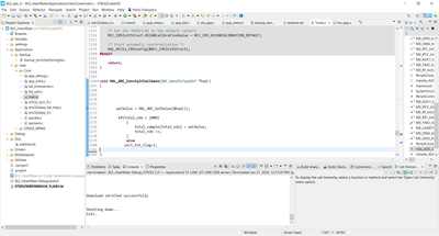

I have already tried... my problem is that I would like to know if I can use HAL_ADC_Start_IT(&hadc1) to acquire 1000 samples in my main independently of the sequencer and then when I have acquired the 1000 samples I send them. Only by doing this the simple callback in the main I can't even go in with the breakpoint because the sequencer starts immediately. How can I do it
Thanks
