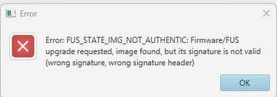

Trying to work on a new board and running into this error when installing stm32wb5x_FUS_fw_for_fus_0_5_3.bin
I know the documents may outline how to navigate this but I would greatly appreciate how to fix this error from experts instead of reading the documents(s).
Please advise.
2024-01-25 6:13 AM
If the original FW version, is not the 0.5.3, then you have to use directly the stm32wb5x_FUS_fw.bin. Try a full chip erase. Then, try firmware upgrade using the stm32wb5x_FUS_fw.bin and following this Wiki.
