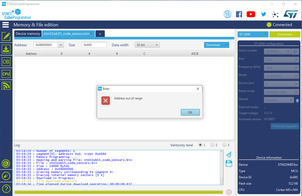

my data is between 0x08000000 and 0x08004D90
2020-06-17 11:13 PM
I could flash my app in 0x08000000. I only ignored the adress out of range error. My data is between 0x08000000 and 0x08004D90.
I performed a full erase but it didn't help :crying_face:
I have two boards . The same app in the other board works properly.
2020-06-18 5:49 AM
Just two things in last resort
1) Use hw reset as the default reset mode in the GUI of CubeProgrammer
2) There are many some digits hidden in the window dedicated to the load address that generate an “out of range�? value? I got some issue with that in the past.
2020-06-18 6:05 PM
here is my window
when i click on "ok" it downloads the binary. When I reconnect, in Device memory he appears in the wanted address 0x08000000
2020-06-19 12:25 AM
So it is a board issue. I will try to get more explaination on the "reserved" error.
I really dont udertsand why you get this "address out of range" error.
I hibk it is 2 different problems.

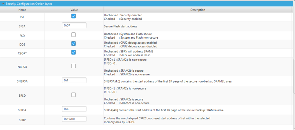

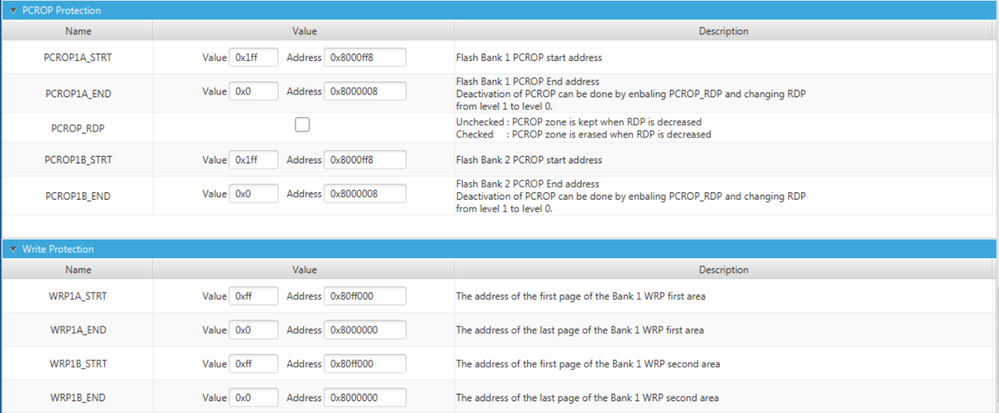

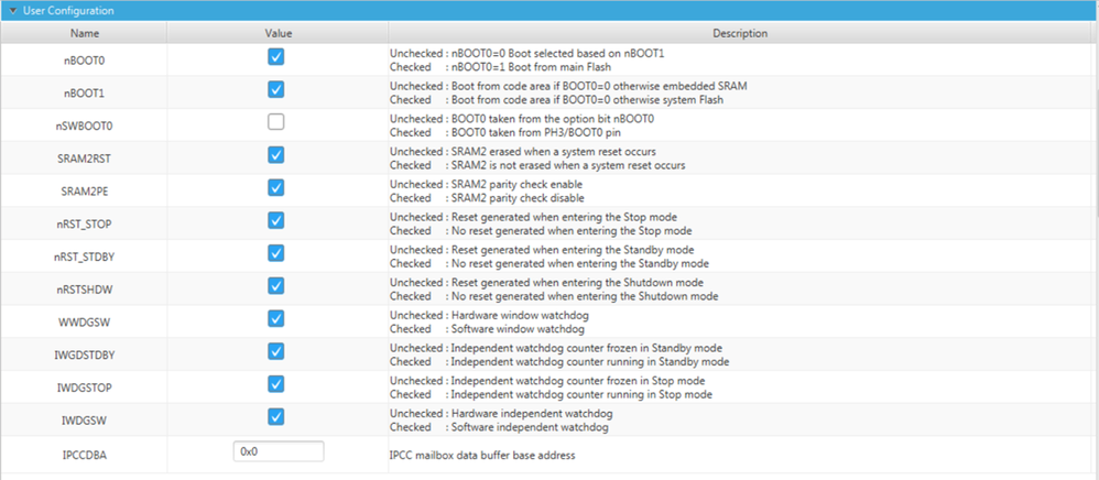

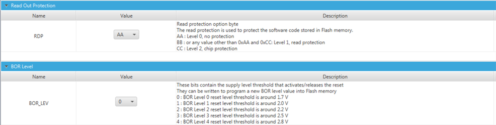

2020-06-19 1:17 PM
Ok.
could you get a look at my options bytes? to check if it is allright there
2020-06-21 11:01 AM
Yes. So could you download them here so that I can check them?
