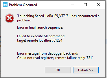

When I try to use STM32CubeIDE I've got this error :

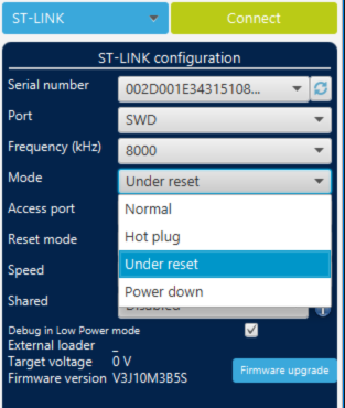

2023-02-07 10:06 PM
You can try flashing the boards with Under Reset mode, I have had some luck with this with a similiar error message.
However it does sound like Seeed may be the more appropriate location for support.
Good luck.
