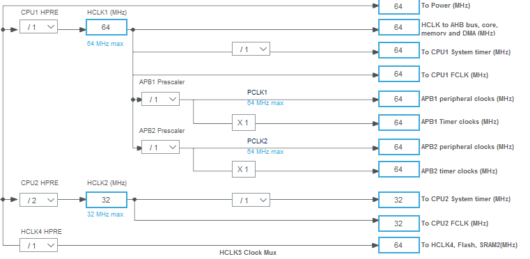

Hello, I want to develop a software which includes an external interrupt for sleep mode and it should be enabled before entering sleep mode. For this purpose, I use:
HAL_NVIC_SetPriority(EXTI0_IRQn, 0, 0) ;
HAL_NVIC_EnableIRQ(EXTI0_IRQn);
When I choose HCLK4 HPRE at bottom as /2, giving 32 MHz to HCLK4, Flash and SRAM2, it works as expected, but when I choose it as /1,giving 64 MHz, code gets stuck at HAL_NVIC_EnableIRQ function. If I exclude interrupts, my software work well with /1 HCLK4 HPRE. Could you help me? Thank you in advance.

2023-04-06 6:57 AM
Thank you for your answer. I used CubeMX for generating clock configurations and it is equal to 3 as you said. I tried in a default STM32 example and it doesn't work at 64 MHz, changing it to 32 MHz solves the problem. Could it be because of some issue about interrupt priorities in the software?
