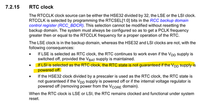

my doubt is if LSE works, even LSI also should work. as we can see in the diagram both LSE and LSI are in the same Backup domain.

As you can see on the paragraph 32.2 of the RM0453. The RTC is functional in VBAT mode and in all low-power modes when it is clocked by the LSE. When clocked by the LSI, the RTC is not functional in VBAT mode, but is functional in all low-power modes except Shutdown mode.
So, it will keep working in Vbat mode only will using the LSE.

LSI stops when power is removed, so you can't use it like you want.
Note that even if you could use it, LSI accuracy is awful.
