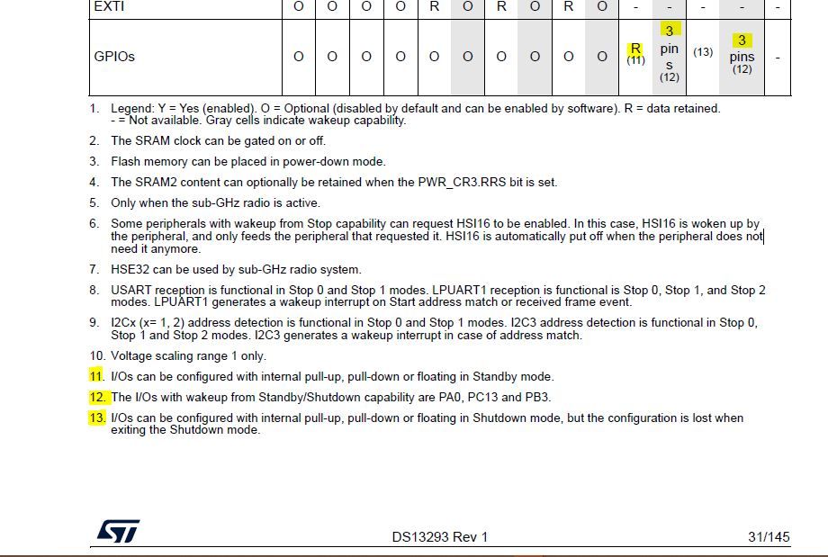

I cannot find the external requirement for wakeup pins PA0, PC13 and PB3 on STM32WL55.
Do they need a pullup (e.g. 10K) to keep the output state once the MCU goes into one of the sleep modes?
Thanks

All GPIOs contain 40K PU/PD resistors. Some of them are maintained in Low pawer modes.
There are no special requirements for external pullups .
VILo , VIHi ,leakage current and other factors determine the max pullup/down resistors.
This is from DS
