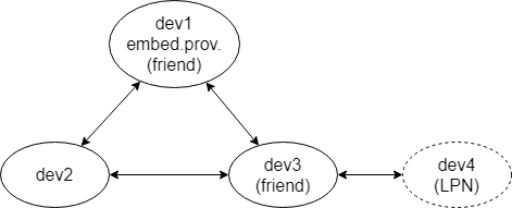

I have a scenario as you can see in the picture below. For creating mesh I am using embedded provisioner (dev1). If I provision dev4, the friendship is automatically established between dev1 and dev4. I want to establish friendship between dev3 and dev4.
What I have to do on the embedded provisioner side or which function should I use on the dev3 to send friend offer to a LPN?
Thank you very much for any advice!
Vit
2022-07-01 6:57 AM
If you reset or switch off dev1, friendship will be established between dev3 and dev4.
Perhaps the best should be to remove Friend feature from dev1.
