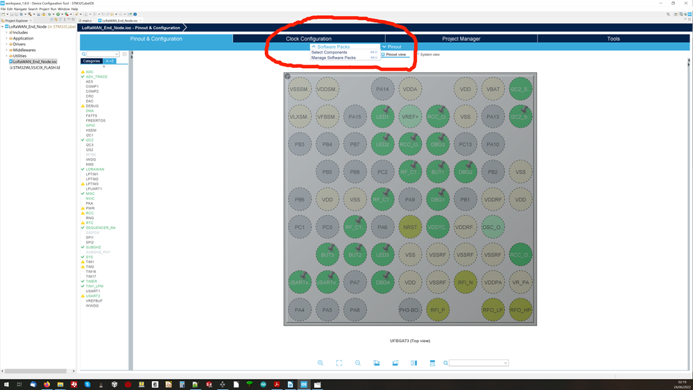

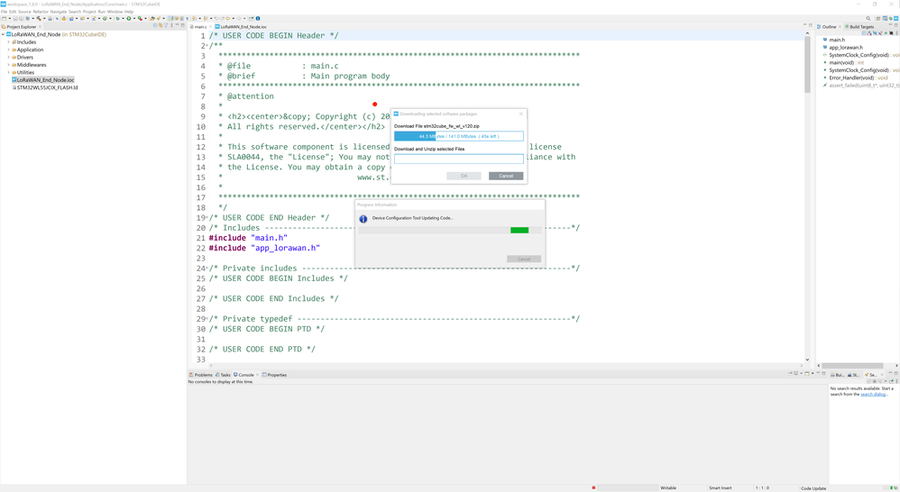

During code generation, CubeMX automatically upgrades the MCU Package to the latest available release (1.2.0).

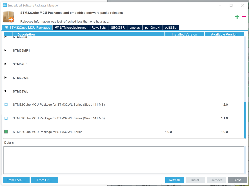

Trying to avoid this, I selected under Software Packs -> Manage Software Packs the Version 1.0.0 but at the moment of generating the code it still uploads version 1.2.0...
