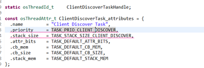

Other problem is below. Could you help me please?
