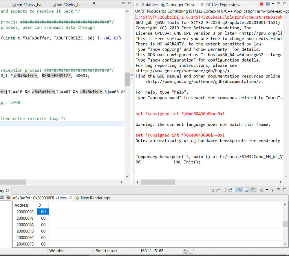

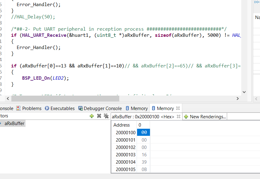

Like you can see here:
The LED is On so I have in aRxBuffer 13 10... (I see these values with an oscillo also..) but we can see it in the memory window...
The memory window is broken ?
Thank you

The code is the UART Polling example of the CubeWL (with some modifications to send AT Command throught UART and receive some data in return). Precisely, I have the impression that there is a link with UART. Indeeed, I can see successfully other variables. I use the NUCLEO WL55JC.
"Could you also enter the aRXBuffer in Expression view and examine the data there?" -> Ok, I will do it
"Could be interesting to have a look at the GDB traces log also!" -> Sorry but how to do that ?
Best regard

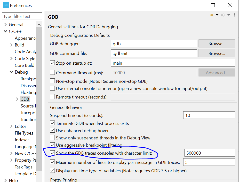

Enable GDB traces:
Then during debug you will get log output in the "Debugger console" view that you can submit here.
