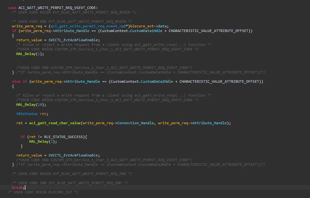

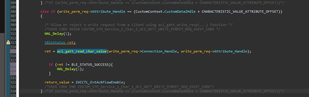

I am currently trying to read the value from a characteristic after detecting that the user has written to it.
I am calling aci_gatt_read_char_value() which is returning 0 (BLE success). From here I am expecting an event which triggers the aci_att_read_resp_event() function but I am not seeing that get called.
However, I am seeing that the Custom_STM_Event_Handler(void *Event) gets called directly after I call this function and the event code is:
I'm not sure what the issue here exactly. Should I be setting a flag and then calling the read function elsewhere? Or is there some other issue with my setup?

The ACI_GATT_ERROR_RESP_EVENT seems to have cleared up by itself. I'm not sure i'm going about this the write way at all. Is there a correct way to access the value that has just been written by the client?
When the client writes to the variable the ACI_GATT_WRITE_PERMIT_REQ_VSEVT_CODE is triggered. Is it correct that I am calling the read function here? Or is there just some variable I can read to see what new value has been written to the characteristic?

2023-02-01 3:02 AM
Before calling the read function, you should respond to the write permit request with the write response command. When ACI_GATT_WRITE_PERMIT_REQ_EVENT is received, the application has to check whether the value being requested for write can be allowed to be written and respond with the command ACI_GATT_WRITE_RESP. You can refer to STM32WB_BLE_Wireless_Interface.html documentation to have more detail about ACI_GATT_WRITE_PERMIT_REQ_EVENT and ACI_GATT_WRITE_RESP.

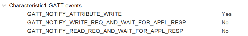

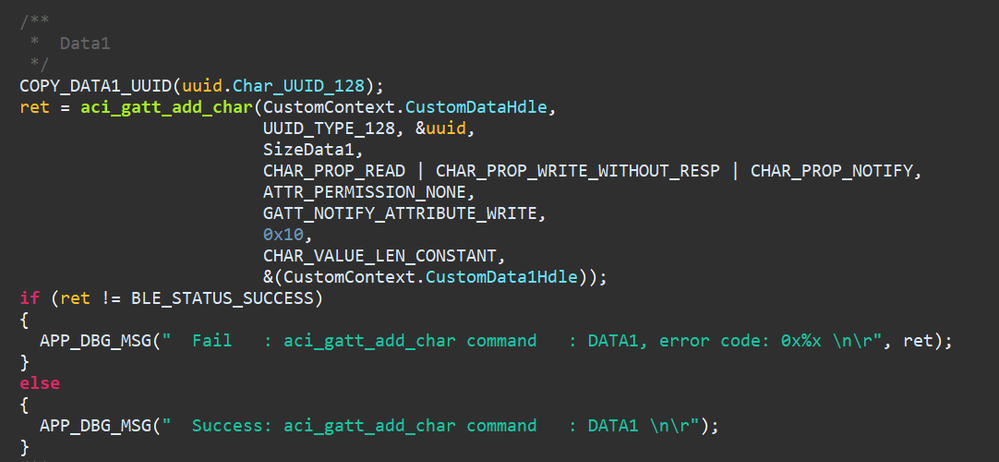

I've removed these from the GATT attributes now:
I want the client to write without me having to give any sort of response and I want to be able to read what they wrote immediately.
I've removed the "wait for response" GATT attributes.
I assume this removes the necessity for me to send any sort of "ACI_GATT_WRITE_RESP"?
What is the step after this to access the newly written value?
