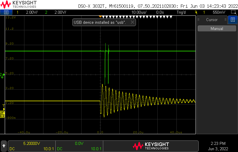

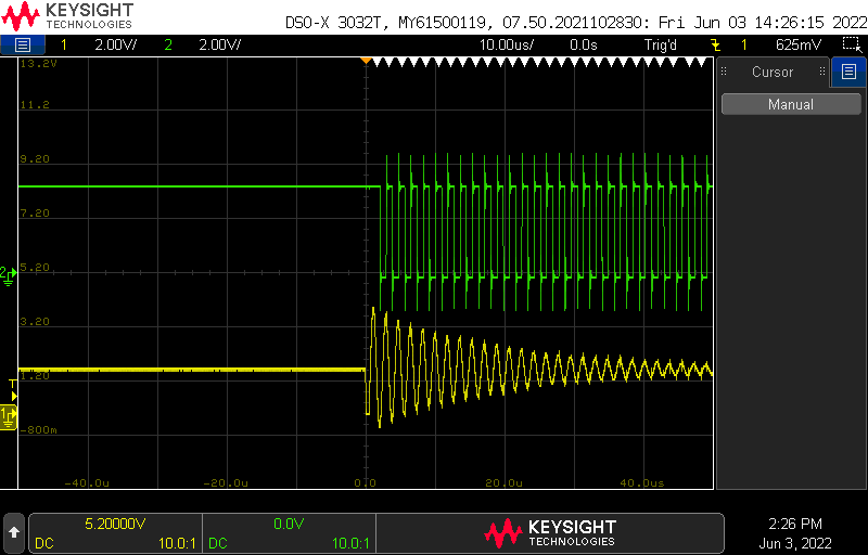

More specifically, when the debug is enabled on stop2 mode using the command HAL_DBGMCU_EnableDBGStopMode() the comp1 is working and I get all the peaks of the oscillation (see image 1). But when I make a single change, and disable the debug on stop2 mode, with the command HAL_DBGMCU_DisableDBGStopMode() the comp1 stops counting all the oscillation peaks (see image 2).
The yellow is the oscillation and the green is the external gpio output of the comparator (see Image 3)

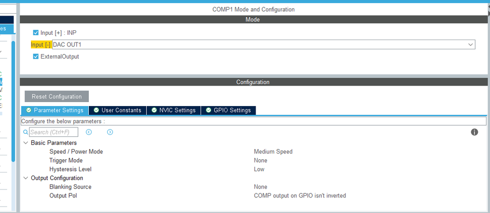

In the STOP2 mode the DAC that i'm using is not retained. If the DAC OUT1 Mode lost then the comparator use false values on Input [-]
But the DAC looks ok.
