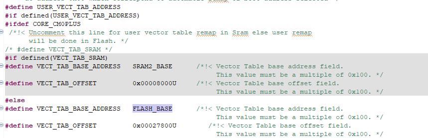

If the start address of CM4 is 0x08000000 and the start address of CM0 is 0x08020000, then everything works well, both applications work fine.
But if i change the address location of the CM0 from 0x08020000 to 0x08027800, the the CM0 doesn't work, only CM4.
The STM32WL55JCIX_FLASH.ld of CM0:
system_stm32wlxx.c
Does anyone have an idea what is wrong?

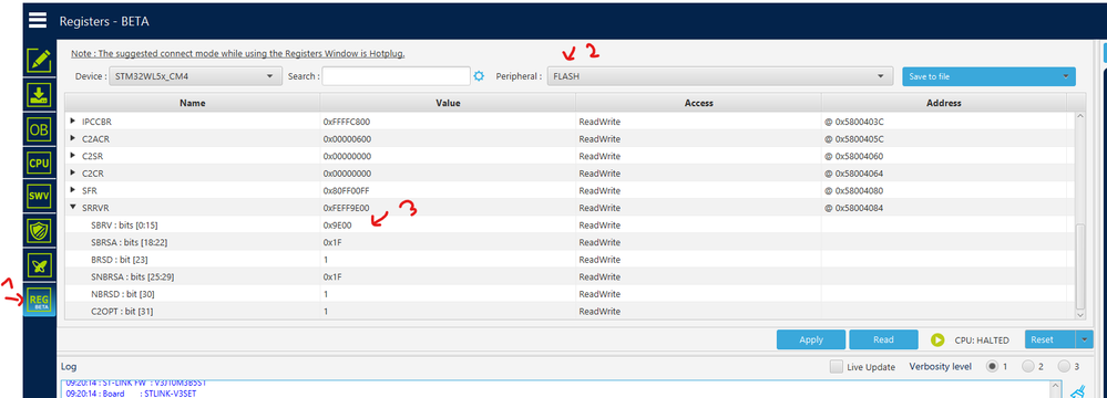

In the end, I found the solution - the SBRV bits in the SRRVR register also need to be modified.
2023-04-05 3:04 AM
2023-04-20 12:37 AM
Can you please write exactly how do you modified the SBRV bits? You used the HAL_FLASHEx_OBProgram function? Do you call that from CM4 before CM0Plus boot?
2023-04-25 12:22 AM - edited 2023-11-20 8:56 AM
I used the stm32 Cube Programmer.
