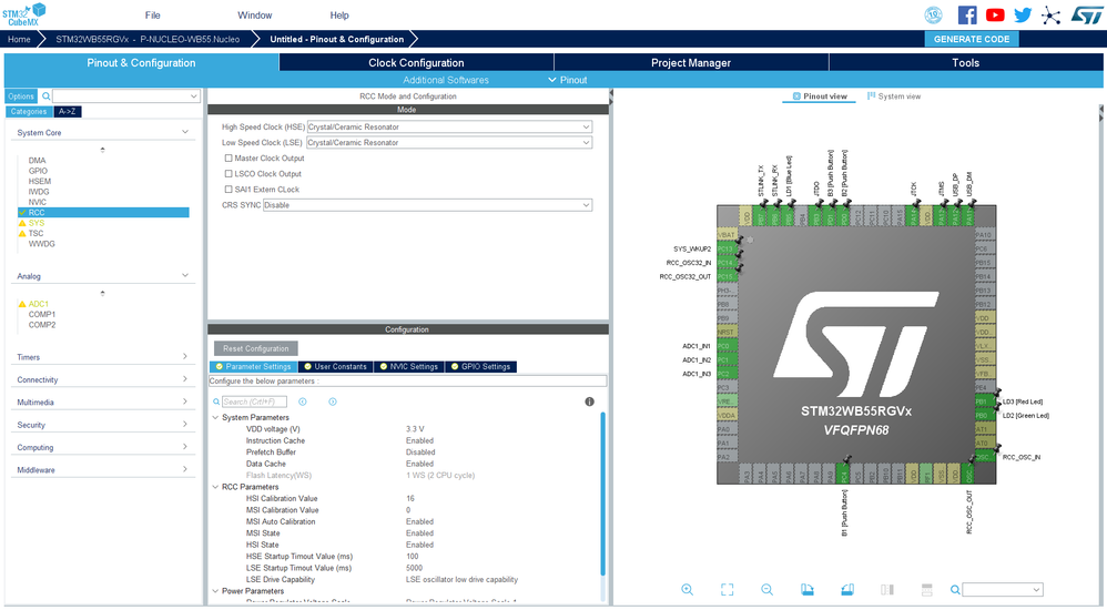

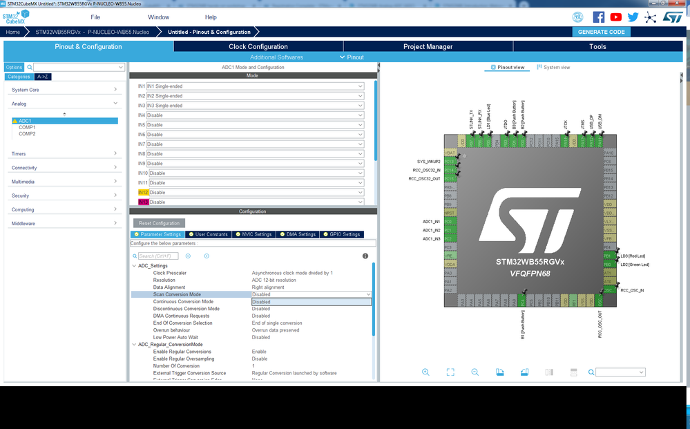

I recently acquired a STM32WB55 nucleo board and I would like to read various analog values through the ADC. My initial idea is to use Multi-Channel Scan conversion mode but i'm unable to enable it in the CubeMX.
All peripherals are enabled in the default configuration for the board provided by the CubeMX but still, no luck.

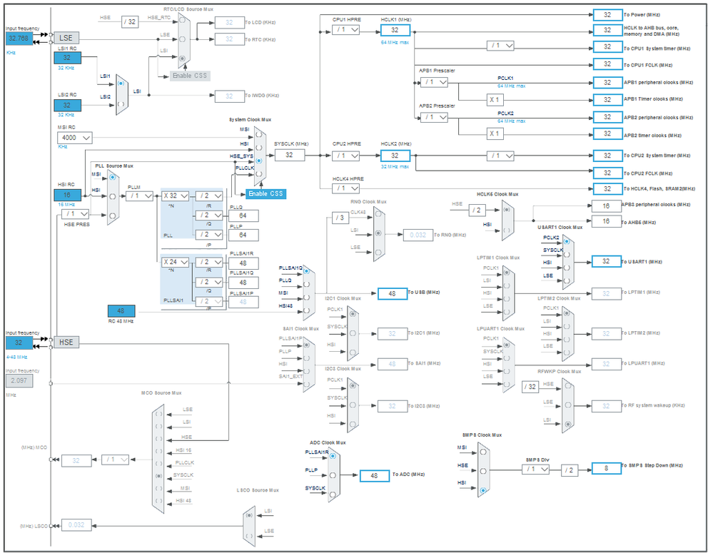

I attach various screen shots of the ADC configuration screen and the CLK configuration screen.

It is counter-intuitive:
first: modify the "Number of conversion", if you want to use 3 channel, put "3"
second: enable the "Scan conversion mode".
This is working for me.
