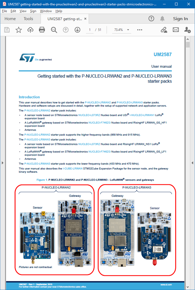

2021-07-13 8:17 AM
The "P-" prefix refers to a "Pack"
The User Manual tells you the difference between the P-NUCLEO-LRWAN2 and P-NUCLEO-LRWAN2 packs:
