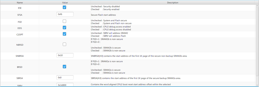

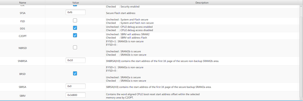

As you requested i read the option bytes on the nucléo with STM32Programmer and via the ST-link interface.
So what do you think about this ? is there something wrong in the options bytes ?
2020-03-30 12:38 AM
No I dont see anything wrong with the secure option bytes.
Could you also provide a dump of the user option bytes? I expect the option byte nSWBOOT0 to be set to 1.
