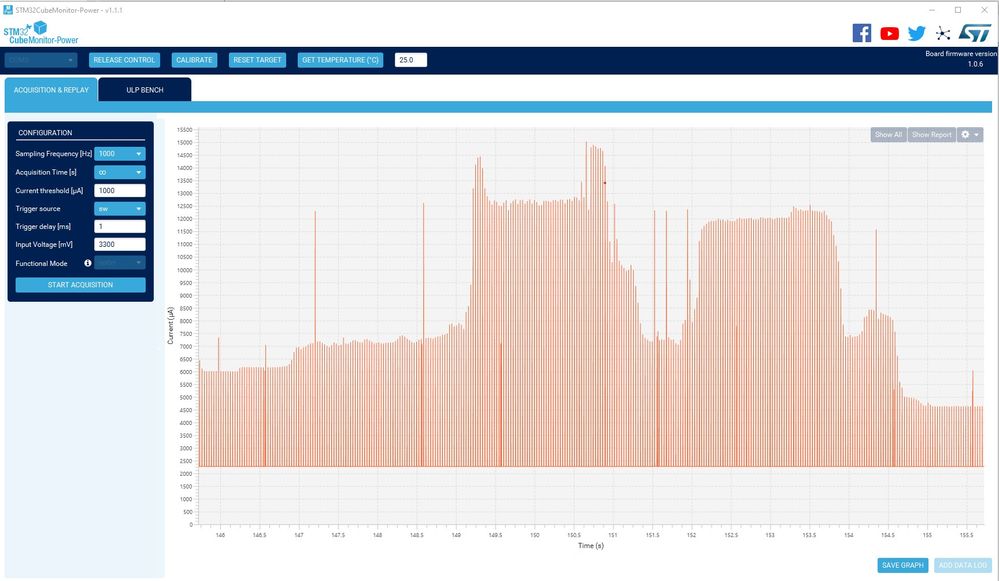

Sorry for jumping into discussion but I just measured the consumption in HeartRate Example (STM32Cube_FW_WB_V1.10.0\Projects\P-NUCLEO-WB55.USBDongle\Applications\BLE\BLE_HeartRate)
but no where I could see 3.6uA with the default options. You mentioned about board configuration or tooling to be incorrect. Where do you think I might be doing wrong given that it`s usb dongle hardware and measuring is over x-nucleo-lpm01a ?
Thanks
