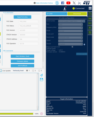

Hello @Exeu,
I was able to install stm32wb5x_Zigbee_FFD_fw.bin v1.24.0 with FUS 2.2.0 on my Nucleo-WB55RG.
Using STM32CubeProgrammer v2.21.0:

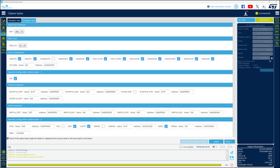

You are getting error message "failed to erase memory", thus I would recommend to check the configuration of your option bytes. Check if there is no RDP / PCROP / Write Protection enabled.
You should have something similar to this:

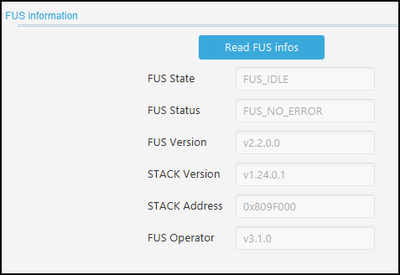

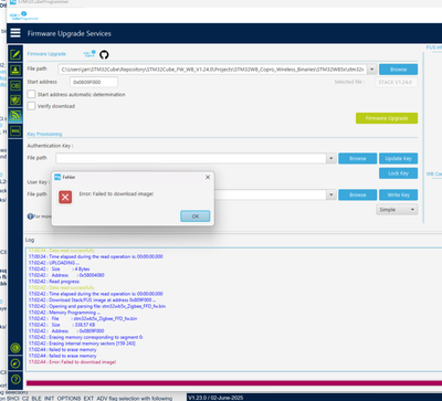

2025-12-21 8:11 AM - edited 2025-12-21 8:12 AM
Hi @Issamos
sure
Here is FUS Info - Before Update

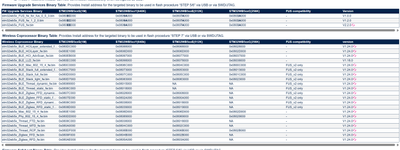

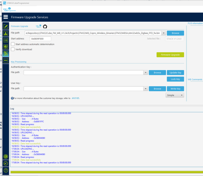

Then the file i have choosen + the correct start address which should be: 0x0809F000 - According to the release notes.
Since i am using the Nucleo board it should be the WB55RG mcu.
Then the error:
This error does not come when i flash any FUS_v2_only binaries - See the screenshot of my reply above with the List coming from the releasenotes file.
The borad is the following: https://www.st.com/en/evaluation-tools/p-nucleo-wb55.html
2025-12-21 11:46 PM
Hello @Exeu,
Best Regards,
Alan Porte
ST MCU Support Team

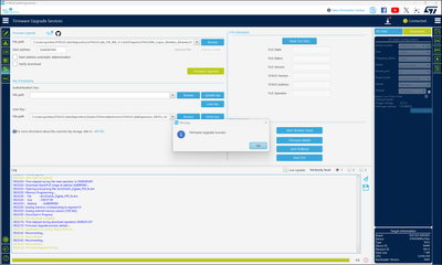

2025-12-22 12:24 AM
Hi @Alan PORTE
I dunno what is the difference from what I tried but it seems to work now.
What is interesting: I tried with the automatic address determination.
This was running through but it also putted the stack on a different address as mentioned in the release notes?
It was up an running then.
After doing this I was also able to flash it with the address which should be the real one..
Have no idea why :face_with_tears_of_joy:
