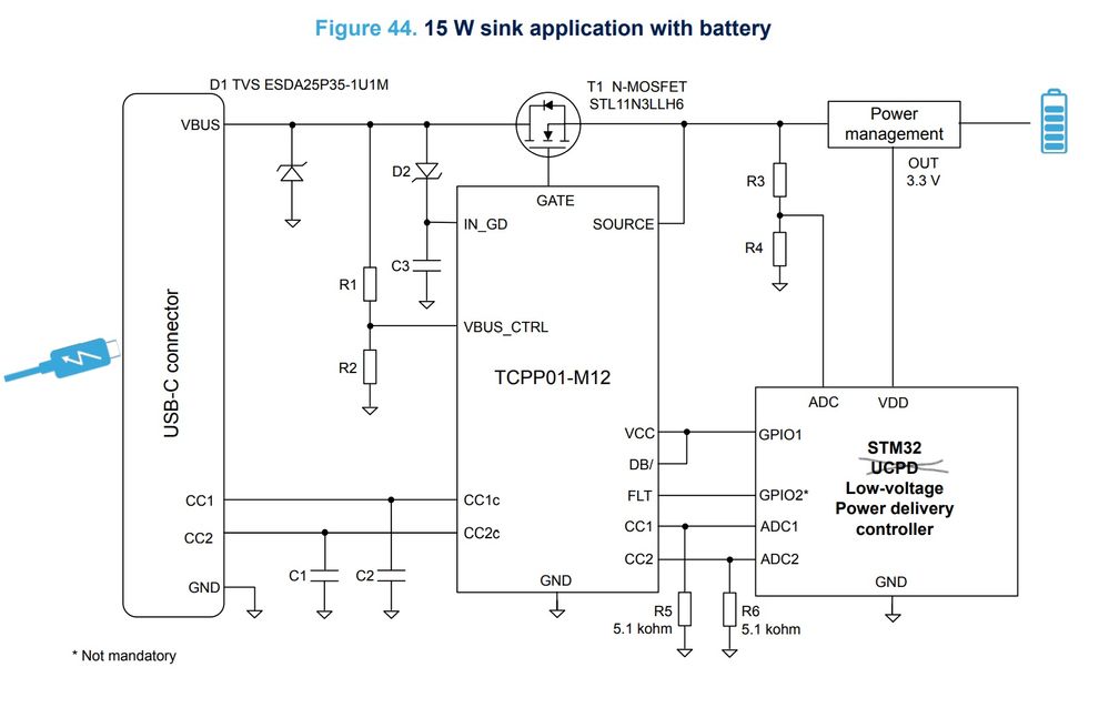

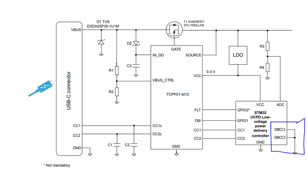

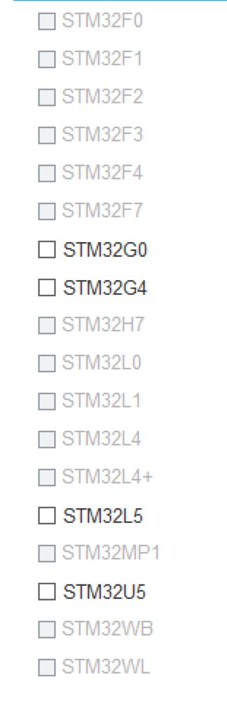

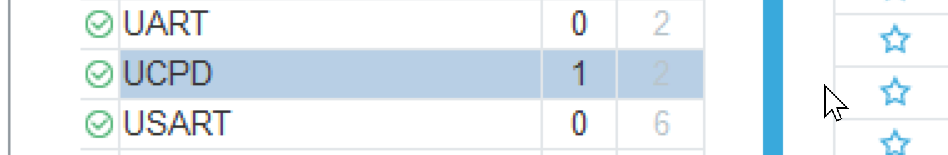

UCPD peripheral is not present in STM32WB series.
UCPD peripheral is present in STM32 G0/G4/U5/L5 series . STM32CubeMx mcu search tools will show:
In your case, have a look in "Figure 44. 15 W sink application with battery":
Regards
