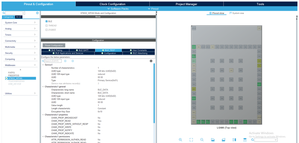

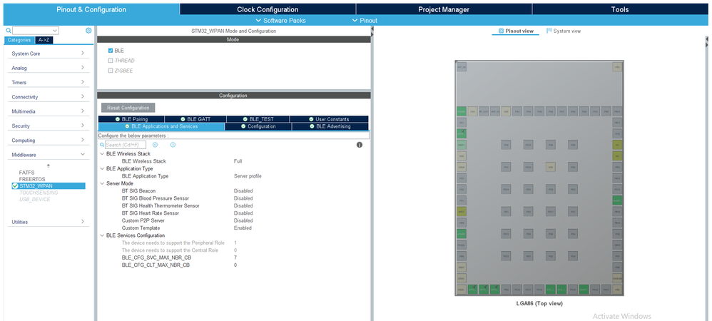

I made custom PCB board with STM32WB5MMG in my project.
I have confirmed that the SWD pins are working and Code is Debugging ok.I have also set up HSEM, IPCC, RCC, RTC, RF, STM32_WPAN required but I can't detect the Bluetooth.
Iam using STM32CUBEMX V6.8.1 and STM32CUBEIDE V1.12.1
Firmware package version is 1.16.0 (STM32Cube_FW_WB V1.16.0)

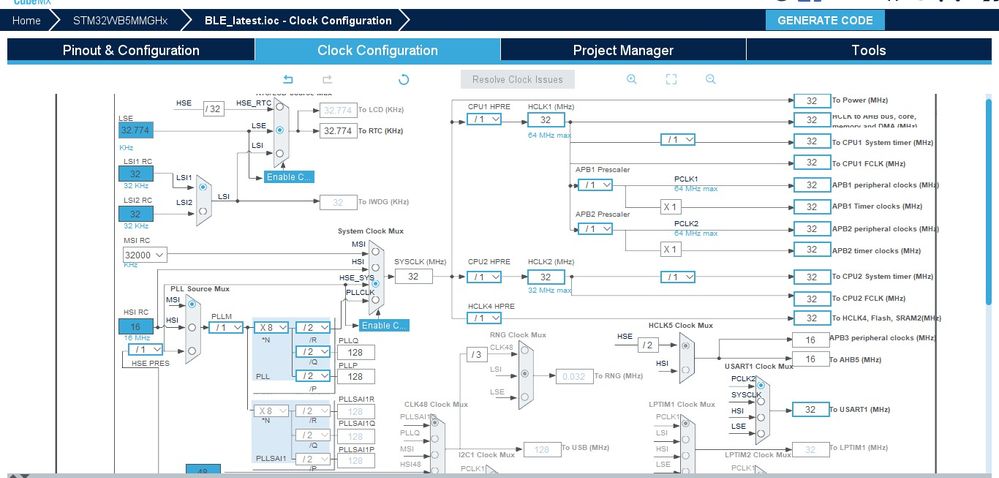

2024-04-01 6:41 AM
Hello @STTwo-32 ,

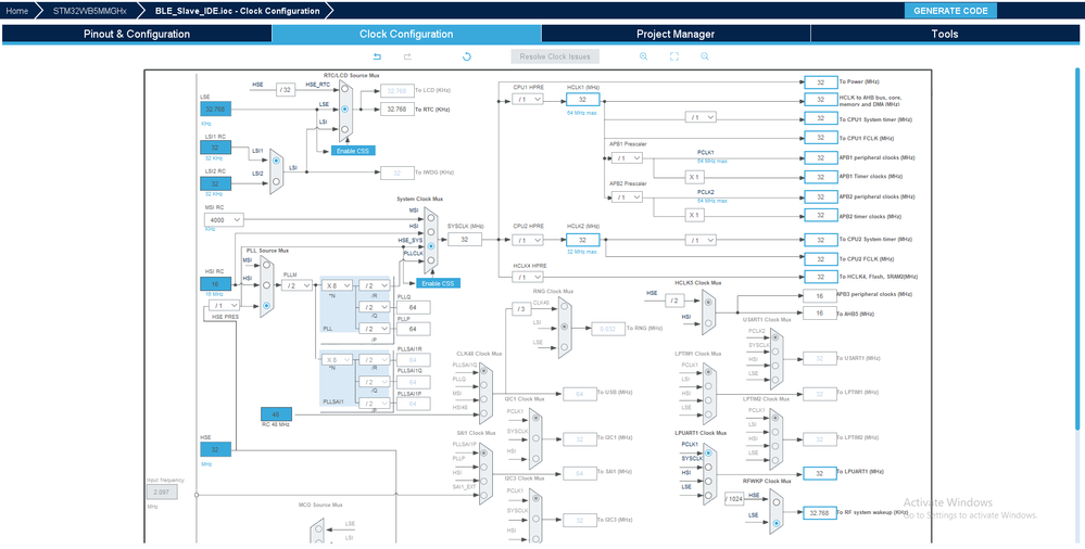

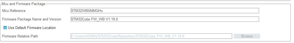

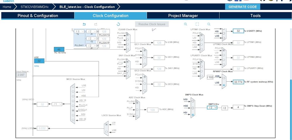

I am trying my code in STM32Cube_FW_WB V1.19.0, the STM32CubeMX V6.11.0 and the STM32CubeIDE V1.15.0. configuration but same result bluetooth is not detecting.After I'm trying example codes of STM32WB5MM-DK but Im not able build and flash, so guide me to build that codes in right way.
These are screenshots of clock configuration of my project,Firmware Package
Iam Unable to build the example codes of STM32WB5MMG-DK Board,

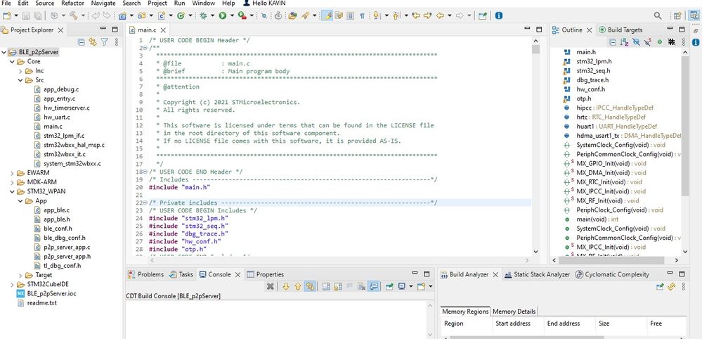

2024-04-01 7:40 AM
If you want to set your own example from scratch, I suggest you refer to the Steps of the WIKI mentioned on my first comment. For the BLE_p2pServer, I suggest you import it as follow:
Now, you will be able to Build your project.
