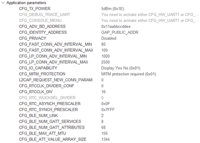

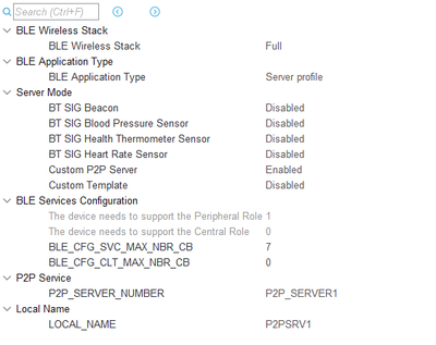

Communication between two STM32WB55 devices via Bluetooth is not working as expected. Device A (the client) cannot receive data from Device B (t

2025-03-20 6:36 AM
welcome to the forum.
Please give details of your setup, tools, what debugging you've tried, etc:
See: How to write your question to maximize your chances to find a solution
Also: How to insert source code
2025-03-23 9:01 PM
/* USER CODE BEGIN APP_BLE_Init_2 */
UTIL_SEQ_SetTask(1 << CFG_TASK_START_SCAN_ID, CFG_SCH_PRIO_0);

2025-03-23 9:04 PM
** CREATE CONNECTION TO SERVER **
** CONNECTION COMPLETE EVENT WITH SERVER
** GATT SERVICES & CHARACTERISTICS DISCOVERY
* GATT : Start Searching Primary Services
ECODE: 0xc0a
ECODE: 0xc0a
-- GATT : P2P_SERVICE_UUID FOUND - connection handle 0x801
aP2PClientContext[index].P2PServiceHandle 0xc
aP2PClientContext[index].P2PServiceEndHandle 0x11
ECODE: 0xc11
2025-03-23 11:25 PM - last edited on 2025-03-24 2:40 AM by Andrew Neil
为什么在以下日志之后 ECODE 更改为 0xc11:ECODE: 0xc0a, ECODE: 0xc0a, -- GATT: P2P_SERVICE_UUID FOUND - 连接句柄 0x801, aP2PClientContext[index].P2PServiceHandle 0xc,aP2PClientContext[index].P2PServiceEndHandle 0x11?
Google translate:
Why does ECODE change to 0xc11 after the following logs: ECODE: 0xc0a, ECODE: 0xc0a, -- GATT: P2P_SERVICE_UUID FOUND - Connection handle 0x801, aP2PClientContext[index].P2PServiceHandle 0xc, aP2PClientContext[index].P2PServiceEndHandle 0x11?
2025-03-24 2:40 AM
Again, please see How to insert source code.
