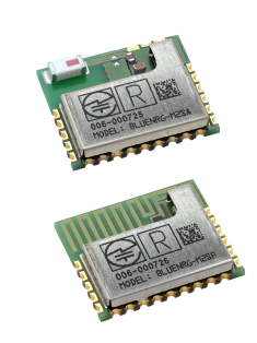

There are 2 versions:
  1. On-board chip antenna (BLUENRG-M2SA);
  2. PCB antenna (BLUENRG-M2SP).
https://www.st.com/en/wireless-connectivity/bluenrg-m2.html
So which one do you have?
Dimensions are in the datasheet.

thanks for replying, i have both of them :
