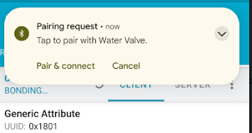

My phone gets the following message to which I respond with the correct number. What you seem to suggest is that I have a display on my server as well and then when the number pops up on the server display I am to use that on the phone end. Does this sound correct??

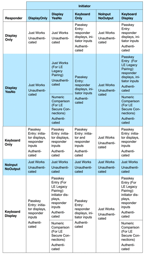

Yes that is correct. This is because you have the server IO capabilities set to Display only. Since the client is on the phone , the app developers obviously set the IO capabilities to "Keyboard and Display" so you do not have to worry about that.
In the scenario where either of the device has NO Keyboard and NO Display, per the diagram above, the BLE connection will be established with the "just works" mechanism.
