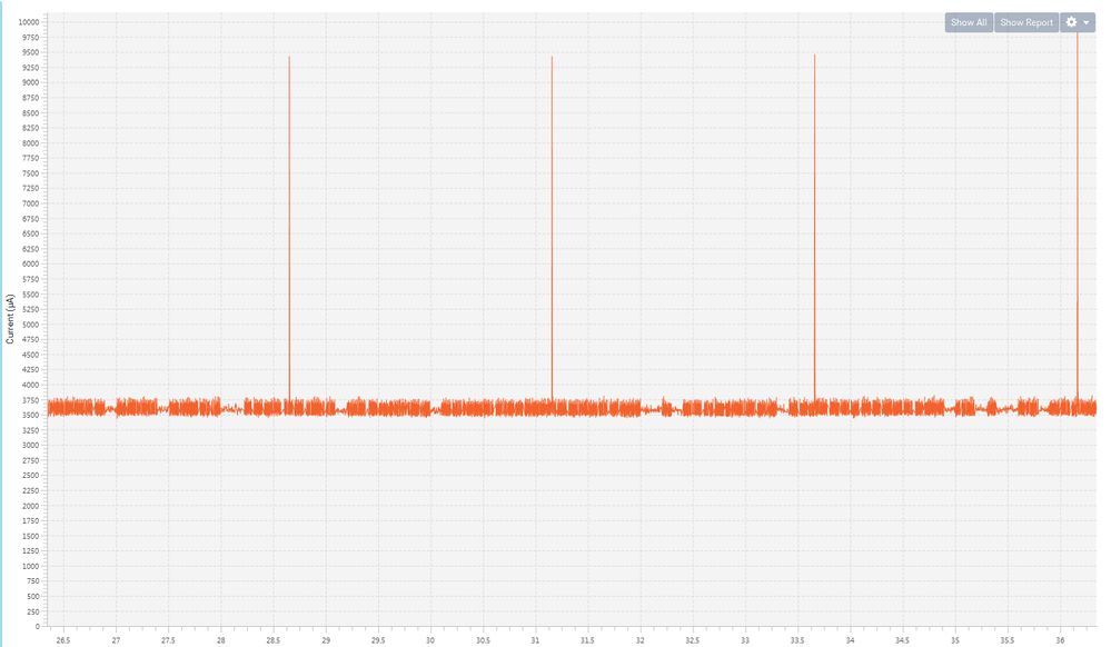

so I took some recordings with the STM32CubeMonitor-Power tool.
This is recorded with 100kHz sample rate. The STM32WB is supplied via a step down converter converting 3V3 to 1.8V. The current messurements are taken on the 3V3 side.
You can see the advertising events and the base current consumption of both cores is at about 3.5mA at the 3.3V side (should be arround twice that much on the 1.8V side (calculated with a very conservative 90% efficiency ).

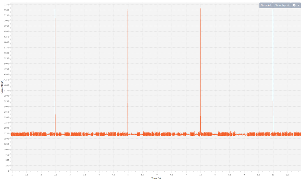

2. Advertising: 2.5 seconds with enabled Sleep mode in the same routine as mentioned above:
you can see that the current goes back to almost half the previous value when there is nothing to do.

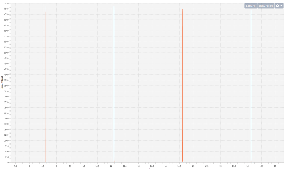

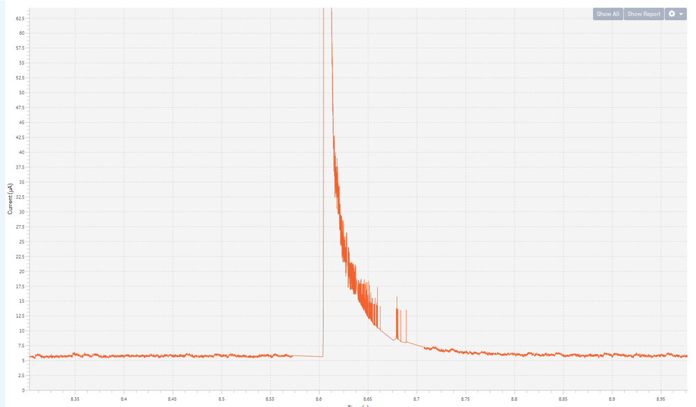

3. Advertising 2.5 seconds with enabled stop 2 mode: This is measured with the debugger disconnected. It draws additional current.
Now the two cores are in stop2 mode consuming only about 6uA on the 3.3V side (my step down regulator has arround 80% efficiency at this point).

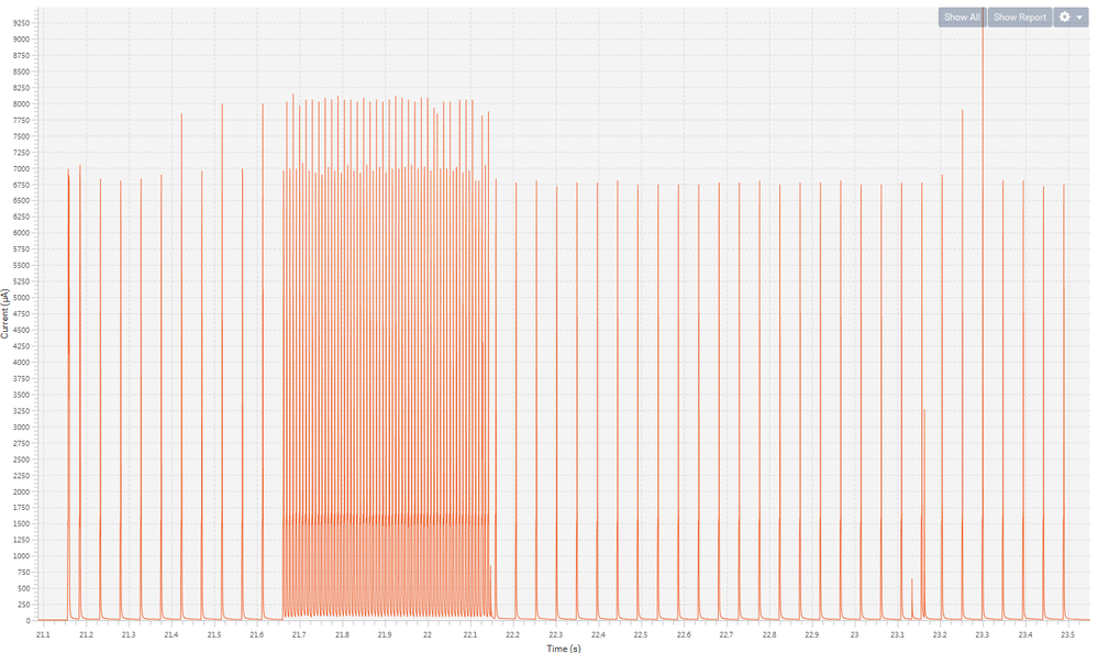

4. Establishing a connection with Stop2 mode. Here you can see the current consumption while establishing a connection. Please bear in mind that this changes the interval from advertising interval to connection interval. At the start the interval is usually at arround 50ms which increases your current consumption.
This could explain your higher current as soon as you connect your device.
