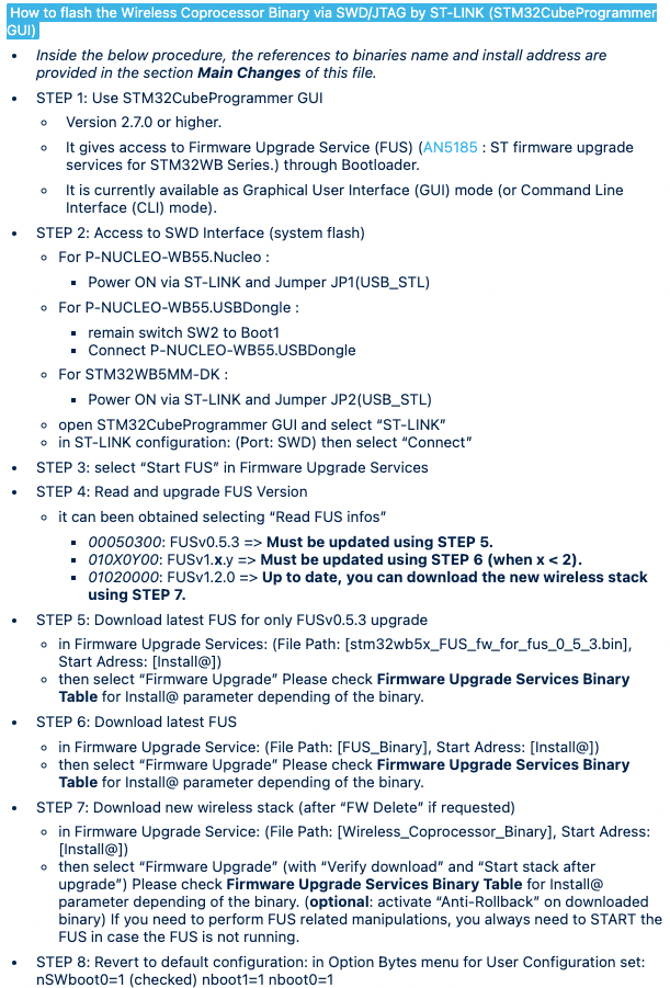

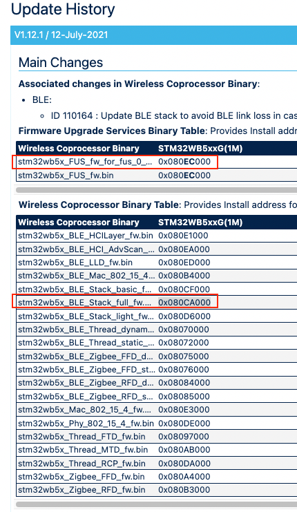

What i did:
according to
file:///Users/<username>/STM32Cube/Repository/STM32Cube_FW_WB_V1.12.1/Projects/STM32WB_Copro_Wireless_Binaries/STM32WB5x/Release_Notes.html
I followed the instructions: 0693W00000DnehoQAB.pngand used the table:
0693W00000DnehKQAR.pngto upgrade the FW to the right address. but now nothing works.
Any help is appreciated to get the Nucleo board back to its original state :)
