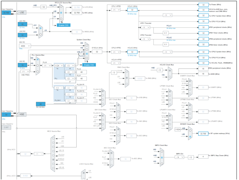

}Clock config (sorry for poor resolution):

After watching the workshops (from 2019) again, https://www.youtube.com/watch?v=zNfIGh30kSs & https://www.youtube.com/watch?v=tPqHUqiWsvs, I think this could be related to the LSE and RF-wakeup? Though I'm pretty sure my custom board is build according to the recomendations given by ST.

In order to check if there's an issue with the clock, could you configure the MCO pin to output the clock and view it in a scope. If there's a perturbation it should be (after some looking around) visible there.
Maybe @Remi QUINTIN can provide some more hints regarding this case.

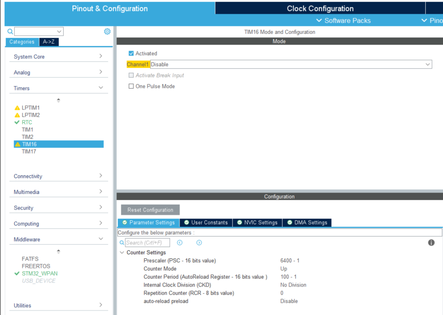

I've done some digging around on in the forum. It seems the Hardware timers is a viable substitute for the Hardware-Time-server - My application is not using all of them.
I'm getting the results a want with (periodic notify that updates a characteristic):
Logic:
/** In custom_app.c **/
void Custom_APP_Init(void)
/* USER CODE BEGIN CUSTOM_APP_Init */
// Register additional tasks - eg for notify
APP_DBG_MSG("\n**APP INIT BEGINING**\n");
UTIL_SEQ_RegTask(1<<CFG_TASK_SAMPLES_NOTIFY, UTIL_SEQ_RFU, vibration_sample_action );
// register timers - for notify callback
// HW_TS_Create(CFG_TIM_PROC_ID_ISR, &Custom_App_Context.Update_timer_Id, hw_ts_Repeated, Sample_update_callback);
// Init the context
Custom_App_Context.Sample_not_value.Max = 0xFF;
Custom_App_Context.Sample_not_value.Min = 0x00;
Custom_App_Context.Sample_not_value.Value = Custom_App_Context.Sample_not_value.Min;
Custom_STM_App_Update_Char(CUSTOM_STM_VIB_SAM, DUMMY_DATA);
APP_DBG_MSG("\n**APP_INIT FINISHED!**\n");
/* USER CODE END CUSTOM_APP_Init */
return;
/* USER CODE BEGIN FD_LOCAL_FUNCTIONS*/
void HAL_TIM_PeriodElapsedCallback(TIM_HandleTypeDef *htim){
if (htim == &htim16){
// callback to SAMPLE_NOTIFY_CHARACTERISTIC enabled
// APP_DBG_MSG("\n## Sample_update_callback() ##\n");
UTIL_SEQ_SetTask(1<<CFG_TASK_SAMPLES_NOTIFY, CFG_SCH_PRIO_0);
static void vibration_sample_action(void){
NotifyCharData[0] = Custom_App_Context.Sample_not_value.Value;
++Custom_App_Context.Sample_not_value.Value;
NotifyCharData[1] = Custom_App_Context.Sample_not_value.Value;
if (Custom_App_Context.Sample_not_value.Value > Custom_App_Context.Sample_not_value.Max){
// reset
// Custom_Vib_not_Update_Char();
Custom_Vib_not_Send_Notification();
/* USER CODE END FD_LOCAL_FUNCTIONS*/Timer configuration:
+ TIM16 --> NVIC Settings --> Enable interupt
