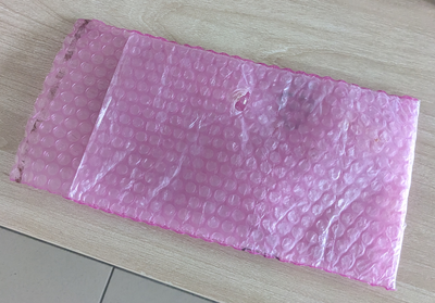

After new tests, I finally succeeded in reaching the expected communication range with the B-WL5M-SUBG1 board.
My main issue is that I was using a plastic pocket to protect the board from rain. However, the pocket I used appears to be ESD-proof and effectively mitigates a lot of my radio signal.
For those interested, I managed to reach about 900m without the plastic pocket, using the same radio configuration as in the initial post. Also, one of my boards was lying on the ground, so better results should be expected with both antennas placed 1m above the ground.
Yet, if someone can answer me, whether a 50-ohm impedance matching on these boards is expected to achieve the best results. I would be glad to know the answer.
