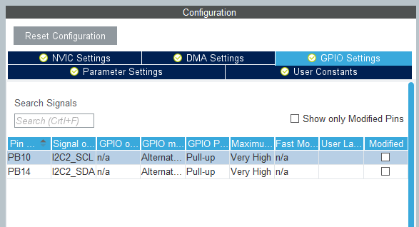

I tried to configure it with CubeMx:
But, i did not found the PB10 on the Board?
There are other pins for I2C2?

2020-06-03 12:43 PM
I don't believe PB10/PB11 escape the module board, and not sure if they connect to anything internally.
https://community.st.com/s/feed/0D50X00009bLS7uSAG
You can attach multiple devices to I2C1, or pick two generic GPIO to bit-bang an additional I2C bus in a pinch.
