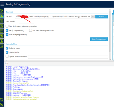

who can tell me if I did something wrong?
really confused why it´s not working at all after I built and flashed the application on astra1b board.
Wireless stack: stm32wb5x_BLE_Stack_full_fw.bin
select the example customUC
change settings to generate bin and hex file
compiled successfully without any error or warning
flash the hex file successfully
but on the board seems nothing is running, no LED blink, no UART connection in device manager.
2023-08-05 1:49 PM
Update:
after I flash StevalAstra1B_BLE_Ota_1.15_LSE.hex at address 0x08007000, it´s working
then it shows me the original problem
