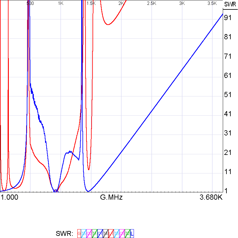

I have tuned the matching circuit from the RF design guide using SimSmith and the S-parameter file as the load.
The S-parameter file doesn't reach up to harmonics of 920MHz but normal sweep does include the file data points when the range is larger.
The first image is a sweep up to 4th harmonic, blue is the S-parameter file (load) and red is with my matching circuit. You can see the discontinuity in the blue line at around 1.3GHz where the S-parameter file ends.

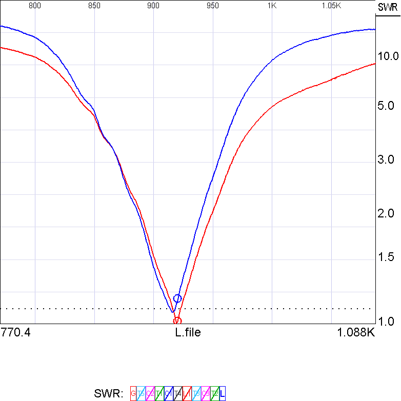

The second image shows the improvement of the matching at 920MHz. The SWR does lower a bit on the higher side of 920Mhz but it should be okay.
Does this seem reasonable to you?

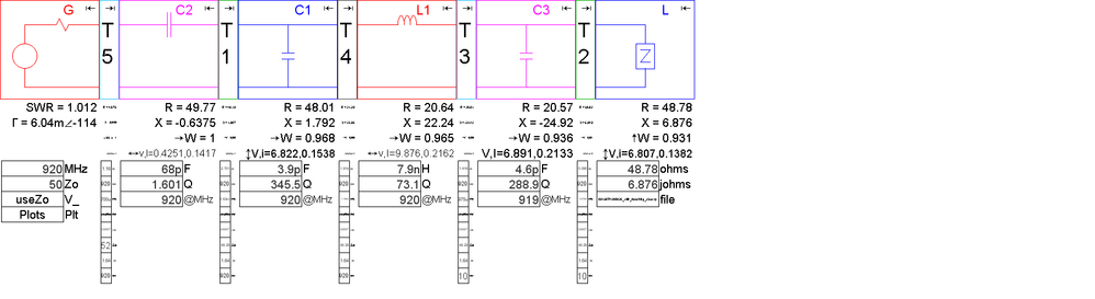

My 920MHz circuit is the following, with very short transmission lines matching the traces on my PCB layout.
