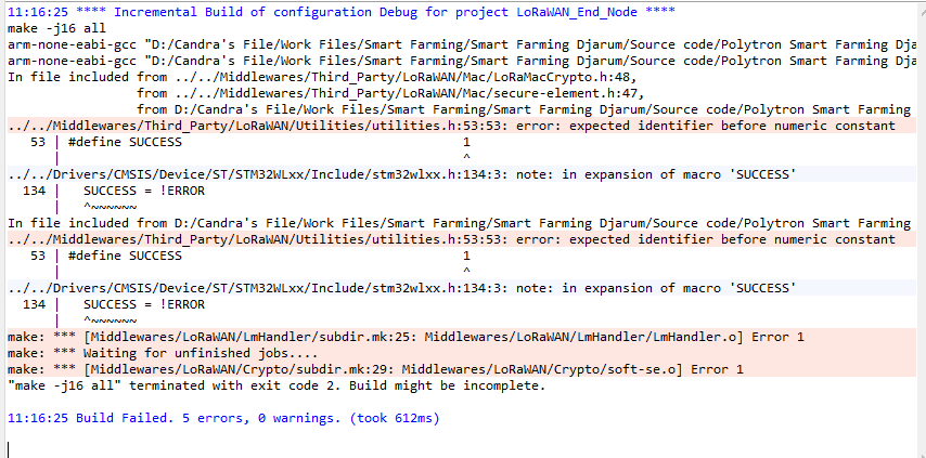

I have function to receive Dev EUI, APP Key, and NWK Key data from UART. Then, I want to put and replace of Dev EUI, APP Key, and NWK Key in se-identity.h with my own data which I have saved in flash memory. But, an error occurs when only include my own file header in se-identity.h after compiling, It also happens to when only include main.h. How can I include my own header file in se-identity.h without error ?
Or maybe there is another way to change Dev EUI, APP Key, and NWK Key without hardcode in se-identity or FUOTA ?
Any assistance would be greatly appreciated
Error occurred:

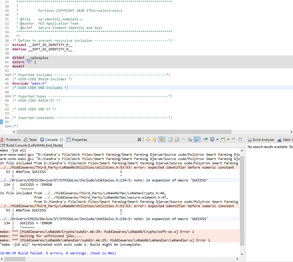

2022-03-10 1:24 AM
Hi @Louis AUDOLY ,
Thank you for your answer. Maybe, I want to share a screenshot of my main case. This screenshot shows an error occurred when I added #include "main.h" in the se-identity.h and compile it. Maybe there is information regarding the troubleshooting, that would be very helpful.
Thank you
