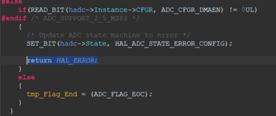

This is the place where HAL_Error is returned
2024-08-22 5:33 AM
Okay, so it sees that DMAEN is set, which it shouldn't be for polling mode. Find out where/why that's being set.
> hadc1.Init.DMAContinuousRequests = DISABLE;
This should make it disabled. Perhaps there is more relevant code that is not being shown?
