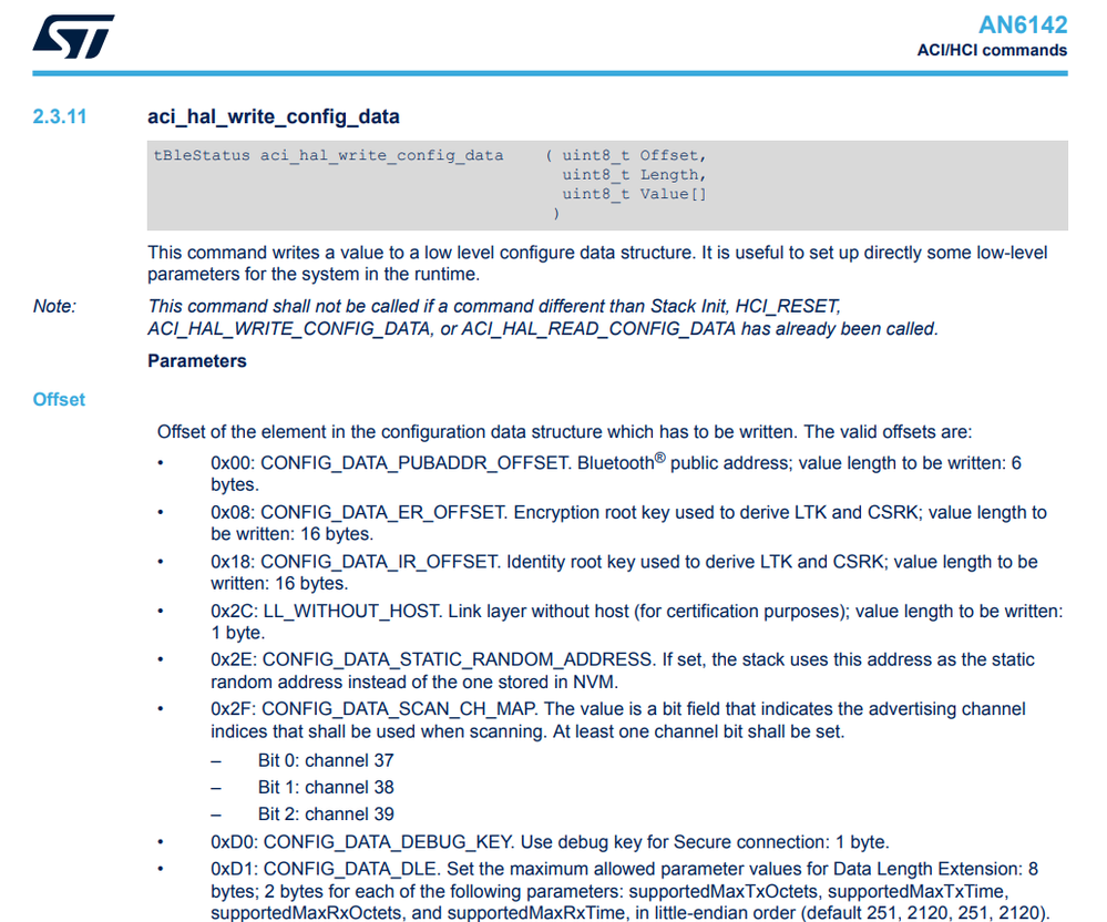

Use offset 0x2E and a 6-byte address for storing a static random MAC address with aci_hal_write_config_data().
Ensure you handle the NVM cache as required by the BLE stack for data retention.
Refer to the PM0271 and AN6142 in section "2.3.11 aci_hal_write_config_data" for valid offsets and command usage.

Thanks for the reply. When I write to 0x2E, it returns 0x12.
I notice "This command shall not be called if a command different than Stack Init, HCI_RESET, ACI_HAL_WRITE_CONFIG_DATA, ro ACI_HAL_READ_CONFIG_DATA has already been called", so what is the formal solution to import our own MAC address (I am sure I used legal MAC address)?
For example, we run p2pService example but with our own MAC address. How to implement it?
