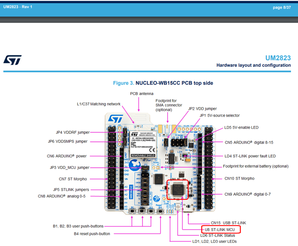

So I took a loser look at what we could save space by removing & immediately noticed that there is a STM32F130CBT6 on the board. I take it this is dealing with the ST-Link?

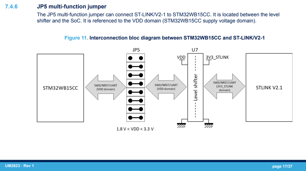

I am relatively new to the STM32 eco-system so am aware that this my be a dumb question but, is it possible to still use ST-link without this & just use the STM32WB55 with ST-Link?

@NicRoberts wrote:is it possible to still use ST-link without this & just use the STM32WB55 with ST-Link?
Yes.
Access via JP5:
See also Application Note AN5165, How to develop RF hardware using STM32WB microcontrollers:
Also check-out the other App Notes, and other docs:
https://www.st.com/en/microcontrollers-microprocessors/stm32wb55rg.html#documentation

@NicRoberts wrote:there is a STM32F130CBT6 on the board. I take it this is dealing with the ST-Link?
indeed:

Do I need the STM32F130CBT6 to control the ST-Link to program a WB55RG or is it included on the NUCLEO for ease of development?
Yes.
Access via JP5:
