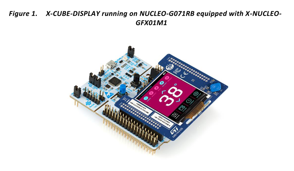

I would like to see this picture fixed in the docs, though. I wasn't aware this was a wireless board.
