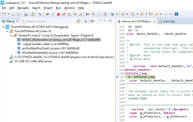

Using the debugger, after crash, I suspend execution.
The PC is in "Infinite_Loop" and call stack in the follow:
What could be the problem ?
2019-07-11 9:25 AM

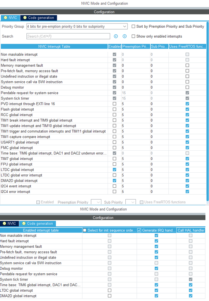

It probably was another unhandled IRQ triggering but when you end up in the Default_Handler your debugger will say it's the WWDG_IRQHandler in the call stack. If you don't have a HardFault_Handler defined that seems like the most likely culprit. If you don't have it defined you can define it to see if it lands there and then can take a look at the hard fault status registers to get a better idea to what might be happening. If it's not a hardfault, I would take a step back and try to see if you have any IRQs that might be firing but are not handled.
2019-07-11 11:51 PM
Yeah, i'd also check that your interrupt vector table is correct. Are you expecting a specific interrupt, or don't you know what might be happening? In any case, it is only hitting the weak symbol and then going to the default handler.

This is the configuration of the NVIC.
