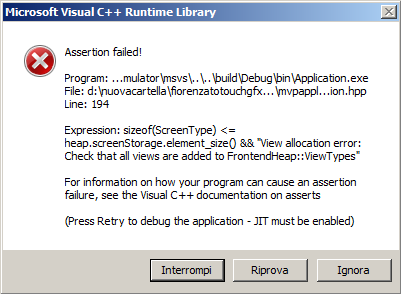

I have this problem just today, my application works as intended if i start it vua TouchGFX designer, but if i start simulator from visual studio, it acts weird, like showing wrong images, and some buttons instead of changing screens leads to this error:

Hi @Zui,
It seems that not all code generated by the Designer has been fully updated in Visual Studio.
Lets have a look at the post generate command used by TouchGFX Designer to update the Visual Studio project:
Open the .touchgfx file in any editor and locate the entry called PostGenerateCommand, to work correctly it should have a command in line with this:
"PostGenerateCommand": "touchgfx update_project --project-file=simulator/msvs/Application.vcxproj",/Anders
