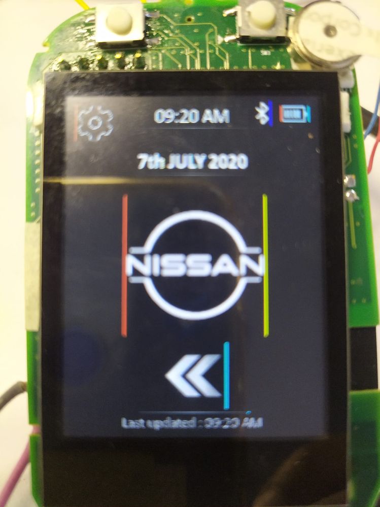

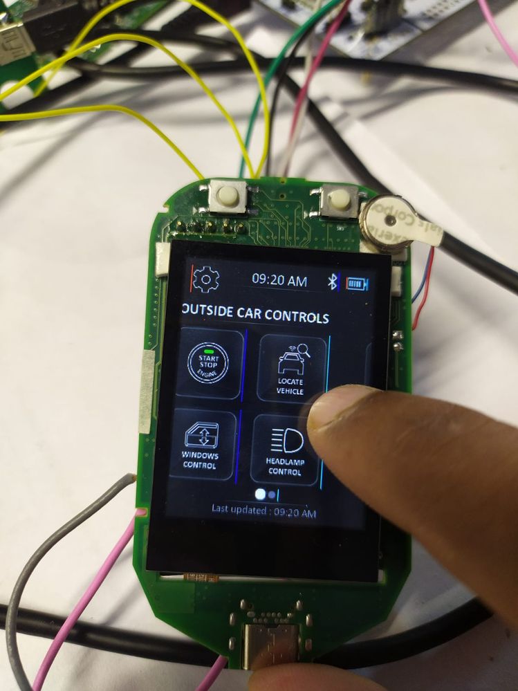

Please find attached image.
We are working on our own design with STM32F769NI and were success in running Touch GFX application.
Configuration changed done on STCUBEMX are
Could you please support us.

Looks like an off-by-one issue managing image width. Check if it is in the bitmaps or the paint process.
2020-12-22 10:04 AM
Why you use RGB666 , TouchGFX can handle only 565 or 888 .
