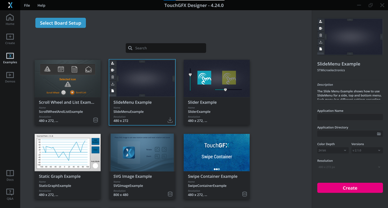

There is a widget called Slide Menu that can implement the functionality you are looking for. You can refer to the example project available in the TouchGFX designer to learn about it usage.
Slide Menu example
I hope this helps you!
2024-08-30 8:12 AM
I've seen these examples, but they do not address the problem I have, which is limited screen real estate to implement a slide menu. I would like the functionality of a dropbox list because it takes up much less space. Can ST help me find a solution?
