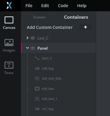

I have been days traying to create an event from a custom container with a toggle switch
under the container I have created an event for a toggle button
I have called the container panel which holds the toggle button and event
under generated gui I see the generated event handler
I then want to copy that event handler in to panel.cpp and create a new event for a custom container

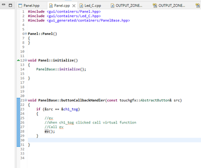

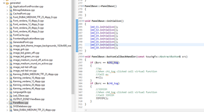

this is the generated code
when i try to add this to add this to panel.cpp (the custom container, just compiler errors ???
void PanelBase::buttonCallbackHandler(const touchgfx::AbstractButton& src)
if (&src== &ch1_tog)
//ev
//When ch1_tog clicked call virtual function
//Call ev
ev();
if (&src== &ch8_tog)
//JIMJIM
//When ch8_tog clicked call virtual function
//Call JIMJIM
JIMJIM();
2023-09-18 7:50 AM
if I only try one event like below....
//ev
//Call ev
ev();
i still get errors ???

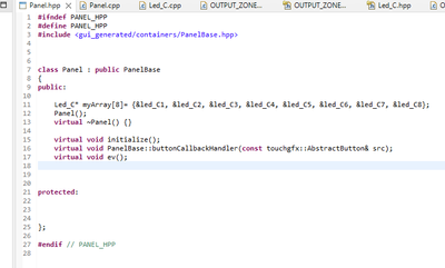

2023-09-18 7:57 AM
from ../../CM7/../../CM7/TouchGFX/gui/include/gui/output_zone1_screen/OUTPUT_ZONE1View.hpp:4,
from C:/TouchGFXProjects/Train/CM7/TouchGFX/gui/src/output_zone1_screen/OUTPUT_ZONE1View.cpp:1:
../../CM7/../../CM7/TouchGFX/gui/include/gui/containers/Panel.hpp:16:18: error: cannot declare member function 'PanelBase::buttonCallbackHandler' within 'Panel'
16 | virtual void PanelBase::buttonCallbackHandler(const touchgfx::AbstractButton& src);
In file included from ../../CM7/../../CM7/TouchGFX/generated/gui_generated/include/gui_generated/output_zone1_screen/OUTPUT_ZONE1ViewBase.hpp:12,
from C:/TouchGFXProjects/Train/CM7/TouchGFX/gui/src/output_zone1_screen/OUTPUT_ZONE1Presenter.cpp:1:
In file included from C:/TouchGFXProjects/Train/CM7/TouchGFX/gui/src/containers/Panel.cpp:1:
make[1]: *** [Application/User/gui/subdir.mk:47: Application/User/gui/OUTPUT_ZONE1View.o] Error 1
make[1]: *** Waiting for unfinished jobs....
make[1]: *** [Application/User/gui/subdir.mk:49: Application/User/gui/Panel.o] Error 1
make[1]: *** [Application/User/gui/subdir.mk:45: Application/User/gui/OUTPUT_ZONE1Presenter.o] Error 1
from C:/TouchGFXProjects/Train/CM7/TouchGFX/generated/gui_generated/src/output_zone1_screen/OUTPUT_ZONE1ViewBase.cpp:4:
from ../../CM7/../../CM7/TouchGFX/generated/gui_generated/include/gui_generated/common/FrontendHeapBase.hpp:15,
from ../../CM7/../../CM7/TouchGFX/gui/include/gui/common/FrontendHeap.hpp:4,
from C:/TouchGFXProjects/Train/CM7/TouchGFX/generated/gui_generated/src/common/FrontendApplicationBase.cpp:6:
make[1]: *** [Application/User/generated/subdir.mk:163: Application/User/generated/OUTPUT_ZONE1ViewBase.o] Error 1
make[1]: *** [Application/User/generated/subdir.mk:145: Application/User/generated/FrontendApplicationBase.o] Error 1
from C:/TouchGFXProjects/Train/CM7/TouchGFX/target/generated/TouchGFXConfiguration.cpp:21:
from C:/TouchGFXProjects/Train/CM7/TouchGFX/target/generated/TouchGFXGeneratedHAL.cpp:21:
make[1]: *** [Application/User/TouchGFX/target/generated/subdir.mk:44: Application/User/TouchGFX/target/generated/TouchGFXConfiguration.o] Error 1
make[1]: *** [Application/User/TouchGFX/target/generated/subdir.mk:46: Application/User/TouchGFX/target/generated/TouchGFXGeneratedHAL.o] Error 1
make: *** [makefile:93: all] Error 2
"make -j8 all" terminated with exit code 2. Build might be incomplete.
15:56:26 Build Failed. 16 errors, 0 warnings. (took 4s.17ms)

Then why you place PanelBase into other class and ask why compiler say error.?

2023-09-18 8:31 AM
this is the code touchGfx generated ???
