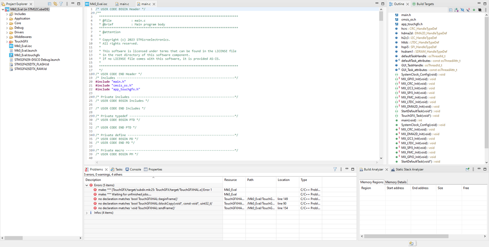

However I am still getting errors when I load the .ioc file up and then generate the code. I have attached the screen shot that you can see below.
Do you have any previous experience of this or how to fix it?
