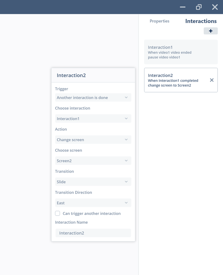

I have a opening screen and when the video is over, I want that to slide next screen. However, when it is over, first frame appears. When I realized it, I tried to learn what is the last frame, but I couldn't. So, How do I obtain the last frame?

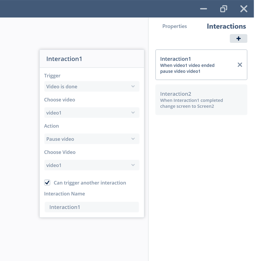

To avoid that issue, you can use a little work-around in TouchGFXDesigner :
By doing that, your video will pause at the last frame, and then your application will switch to the other screen.
