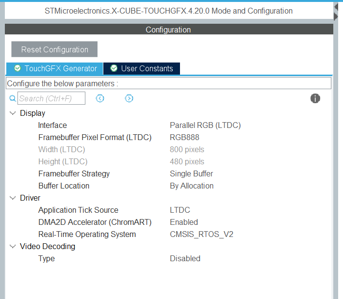

I found out that LTDC interupt callback is not getting called but can't figure why.
Following code is auto generated by CubeMX LTDC interrupt is enabled in NVIC.

There could be several reasons for that but more information is needed here.
First, what is your STM32 ? Have you compared your code with the Board Setup of the closest MCU ?
Could you please specify your display definition, a well as the LTDC frequency you set ?
Do you reach the TouchGFXGeneratedHAL::enableInterrupts() call ?
If not, do you pass the TouchGFXGeneratedHAL::initialize() call successfully ?
What about LTDC registers ? Do you see the interrupts enabled in IER register ?
Could you maybe share more of your project in not all, notably the main.c (with LTDC init, ltdc.c otherwise) and full TouchGFXGenerated.cpp, TouchHAL.cpp and TouchGFXConfiguration.cpp ?
